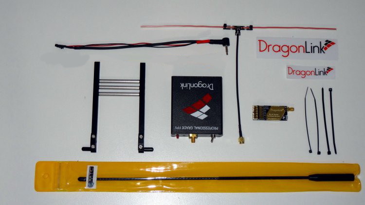

Var går egentligen gränsen för hur lång räckvidd man vill ha eller är nöjd med. Eller vill man bara ha stark signal i skogen vid fpvflygning?
Jag har kikat på olika alternativ med detta och förmodligen beställs så småningom ett Dragonlinkpaket.
Finns fina paket på http://www.readymaderc.com/store/index.php?main_page=product_info&cPath=11_189_190&products_id=994
One of the most popular long range UHF R/C systems, now with the legendary Ready Made RC, LLC support to back it up!
Flawless R/C control anywhere, any distance, any time for Copters, Planes, Cars and Robots... Imagine flying FPV without ever having to worry about failsafes, glitches, Interference in the city, or from surrounding objects. The Dragon Link system just works, no hassles, no extra steps needed, just turn it on and fly. Even though the Dragon Link system will typically have a range of 40 KM with stock antennas, you do not need to be a long range flyer to get the best benefits of this system. The Dragon Link is incredibly resistant to interference, and if you fly a copter in the city at short distances, this is the solution for you. Dragon Link will give you flawless copter control without ever having to worry about interference from buildings or city environments again.
The Dragon Link complete system includes everything you need for long range and high performance RC control, there is nothing additional to purchase. Just order the complete system, and chose the correct options above for your RC Transmitter connection cables and airplane antenna options. NOTE: The Dragon Link system is for RC control only, it does not transmit or affect video transmission in any way.

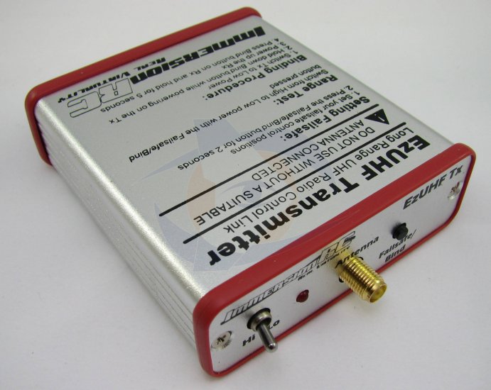

Vidare har vi Immersions EZUHF serie som kostar lite mer men fortfarande mänskliga summor.
Finns också hos readymaderc: http://www.readymaderc.com/store/index. ... cts_id=926
Specs:
-Reliable FHSS Link (Frequency Hopping, Spread Spectrum)
-433MHz/70cm Ham band operation
-GFSK modulation
-600mW (~28dBm) output power
-Direct head-tracker input, adding head-tracker compatibility to most radios
-Power switch, boost power when at long range
-Standard SMA antenna connector, compatibility with 70cm antennas
-Flexible buffered, AC-coupled, PPM input, ensures compatibility with 3.3v thru 9.6v PPM levels
-Standard USB port (Mini-A) for firmware upgrades, and system configuration
-Single pushbutton learning of failsafe positions
-Binding function, which allows binding Single Tx->Rx, Multi Tx->Rx, and Single Tx->Multi Rx
-Mates with 8 channel, and 4 channel EzUHF receivers
-Power sourced directly from the R/C Tx (Futaba), or optional DC power jack
-Built in receiver, for future expansion
-Custom extruded brushed aluminum enclosure

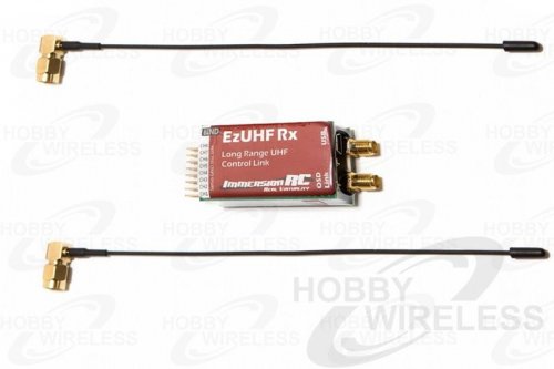

Frekvenser? Jag har hittat en tillverkare som säger att dom går mellan 433-440 MHZ
Tillverkare finns väl säkert lika många som 2,4 ghz radion....
The shit? Säg de. Immersion skulle jag spontant gissa medans de flesta på tuben iaf verkar använda DragonLink
Till flyg för lång räckvidd verkar Dragonlinken som jag visade längre upp visa på flygningar på runt 40KM och mer ibland...
Jag skulle nog välja ExUHF:s lilla 18 grams 8 kanalare för 250 quad.
http://hobbywireless.com/immersionrc-lo ... 1f3343a5c3
Cable Types/Compatibility
Taranis, Turnigy, And Older RC Transmitters with removable RF module
This cable connects the Dragon Link transmitter to ALL RC transmitters that have a removable RF module. It has standard header pins that you connect to the RF module pins which are exposed once you remove the RF module from the back of your R/C transmitter. This is a very quick and easy way to connect your Dragon Link to your RC/ transmitter, as it provides both PPM and power, and is a one cable connection. It is not required to open the RC transmitter to connect via this cable.
NOTE: This cable will NOT work with the New High End Futabas that have a double row of very Tiny Pins when the RF module is used.
Spectrum, JR, Hitec, and Other 2.4 GHZ Transmitters with no removable RF module
This cable has a small " Mini Audio " type plug that plugs into the DSC or Trainer Port output of modern RC transmitters. This is compatible with ALL Spectrum, and JR RC transmitters regardless of model. This cable is a little harder to connect as the DSC / Trainer ports of this type do NOT supply power to the Dragon Link. This cable also includes a JST power connector that must be connected to an external 2-4 cell LiPo or 5 to 18 volts, for an installation that can be done without opening the RC transmitter.
Note: You can connect to the internal switched power of the RC transmitter, but this will require opening the transmitter and some basic soldering skills.
Futaba Square Trainer Port Connector
This is the quickest and easiest way to connect the Dragon Link Transmitter to any Futaba RC transmitter that has the standard Futaba Square type trainer port. Simply Plug in, activate the trainer port in your Futaba transmitter's computer menu, and it will work. We use a genuine high quality Futaba plug, not the cheap chinese ones, for reliable connection and operation.
The Dragon Link is made in the USA and fully guaranteed.

Kollade lite på sändaren. Du har ju en brytare på den... Lo=200mW Hi=500mW
Infon:
Dimensions: L=85mm x W=70mm x H=25mm
Weight: 120g
R/C Channels: Maximum of 12 (future upgrade to 16)
RF Impedance: 50 ohms
Power Output: 500mW (27dBm), with 200mW low-power mode
Modulation: GFSK
Hopping: 20 of 40 slots, 2MHz, or 20MHz frequency spread (Extreme Hopping)
Frequency Band (Std. Firmware): 431-433MHz, 433-435MHz, 435-437MHz, 436-438MHz, 430-450MHz (Extreme Hopping)
Frequency Band (UK Firmware): 459MHz
Power Requirements: 9-12v
Power Consumption: 250mA

Jamen de e ju nästan samma som EzUhf?
