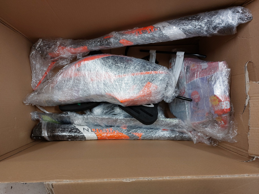

Öppnade lådan

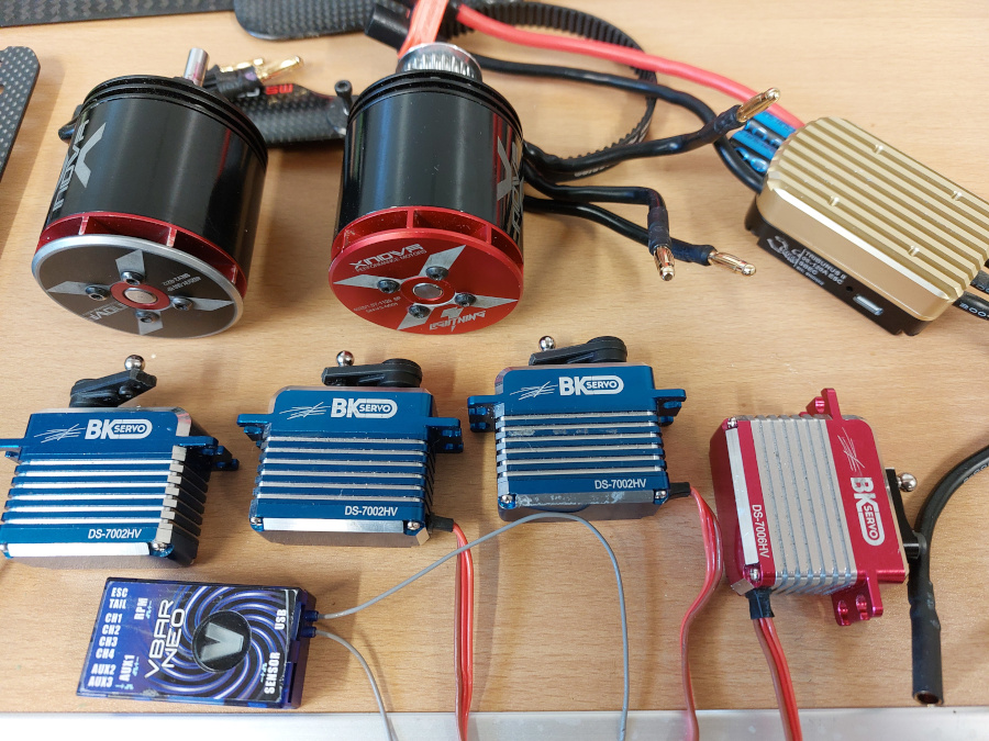

Elektroniken till helikoptern.
3 st BK Servo DS-7002HV
Operation Voltage: 6V – 8.4V , Weight: 66g (2.33 Oz)
Dimensions: 20x40x37mm Frequency: 1520us/333hz , Gear Type: Metal Motor Type: Coreless
Torque: 6.0V: 17 kg/cm (236 oz/in) 7.4V: 19.1 kg/cm (265 oz/in) 8.4V: 21.1 kg/cm (292 oz/in) Speed:
Speed: 6.0V: 0.07 sec/60 , 7.4V: 0.054 sec/60 , 8.4V: 0.047 sec/60
1 st BK Servo DS-7006HV
Operation Voltage: 6V – 8.4V Weight: 68g (2.4 Oz)
Dimensions: 20x40x37mm , Frequency: 760us/333 hz , Gear Type: Metal Motor Type: Coreless
Torque: 6V: 8.4 kg/cm (116.7 oz/in) , 7.4V: 9.6 kg/cm (133.3 oz/in) , 8.4V: 10.6 kg/cm (147.2 oz/in)
Speed: 6V: 0.035 sec/60 , 7.4V: 0.032 sec/60 , 8.4V: 0.03 sec/60
Motor
1 st Xnova 4025-1120KV 1.5Y
Xnova brushless high performance outrunner motor for 520-600 size helicopters for extremely hard 3d flying on 6s. Extreme powerful motor for Goblin 570, Synergy E5 - E6, T-rex 600 or Logo 500 up to Logo 600.
1 st Xnova 4025-560KV 3Y
Xnova brushless high performance outrunner motor for 500-620 size helicopters for sport flying on 8s-10s or extreme flying on 10-12s. Extreme powerful motor for Goblin 570, Synergy E5 - E6, T-rex 600 or Logo 500 up to Logo 600.
Esc
1 st Scorpion Tribunus II 06-120A ESC SBEC
Stored and unstored Governor, external governor.
Data Logging, Data output port for external data logging device, such as Mikado V control / Vbar combinations. Jeti Telemetry , JLog 3 and Futaba.
ESC setup can be set by Mikado V control Radio.
PC connectivity, V link II Cable(optional) plus Diode adaptor(included) cable needed. Micro USB to USB Type A direct to PC.
Supported HvLi battery 6S total 26.1V. Size: 76.7 x 36.5 x 25.4 mm Weight: 120 Grams.
1 st Vbar Neo
