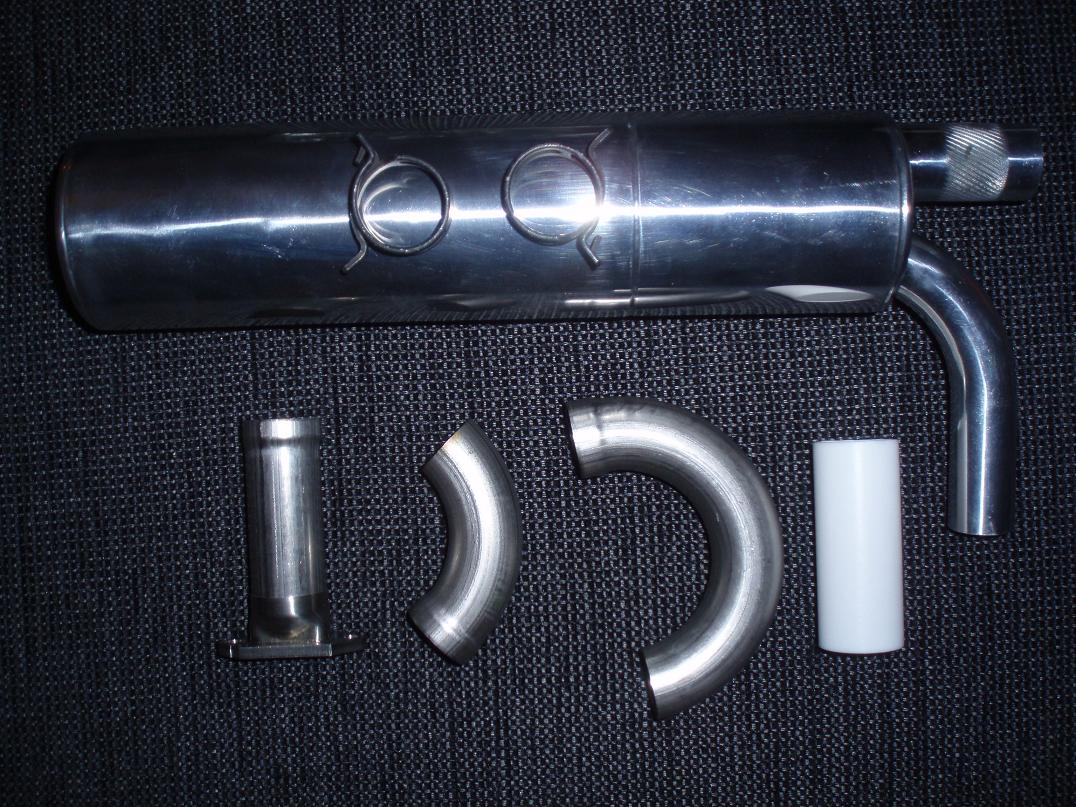

These Muffer can be assembled with DLE 55 and DLE 111 Engine.
It can reduce Noise when you fly the airplane.
Polished Aluminium Canister with Stainless Steel Flexible Header pipe
and teflon couple with two spring clumps.
Stainless Steel Flexi Header -340mm from centre of exhaust flange to tip
Corrogated section 200mm long and 34mm DiameterTail Section 100mm long
25mm Diameter Outlet canister muffler 252 mm long not including pipe
65mm(or 60mm) Diameter Body (67mm at weld seam)25mm Diameter Inlet pipe
16mm Outlet
You will need to buy two sets for twins like the the DLE111/DA100,Canister can
be used with other brand 25mm headers if needed to suit your install, instead of
the supplied flexi header.
Also suits many other Chinese engines 40 - 60cc per cylinder with ~42mm bolt
hole spacing on exhaust header such as MT50/57/CRRC etc.
Weight:
Canister = 250 gram
Flexi Header = 130 Gram
Both Clips = 15 Gram
Teflon Coupler = 25 Gram.
Total Weight = 420 Gram

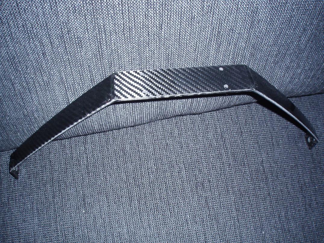

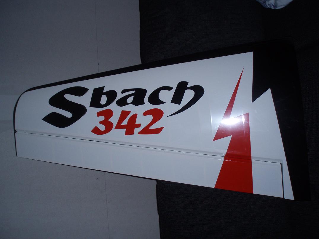

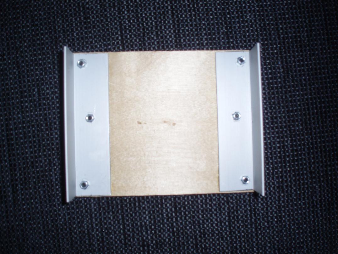

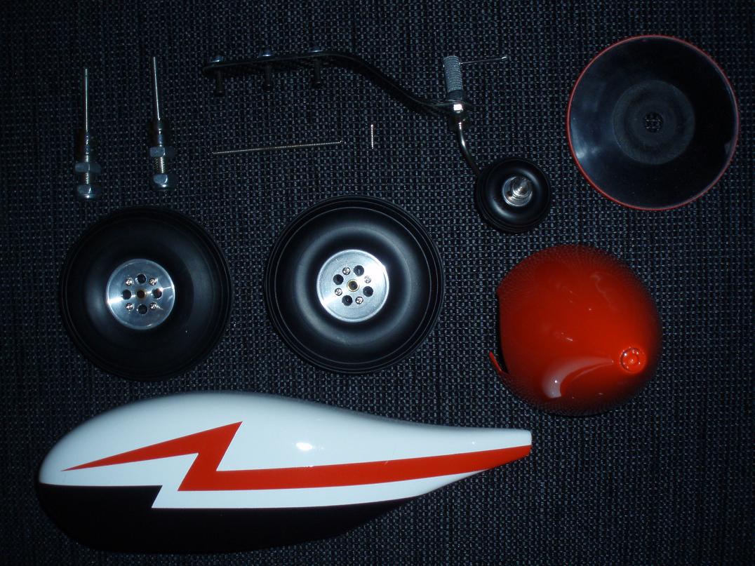

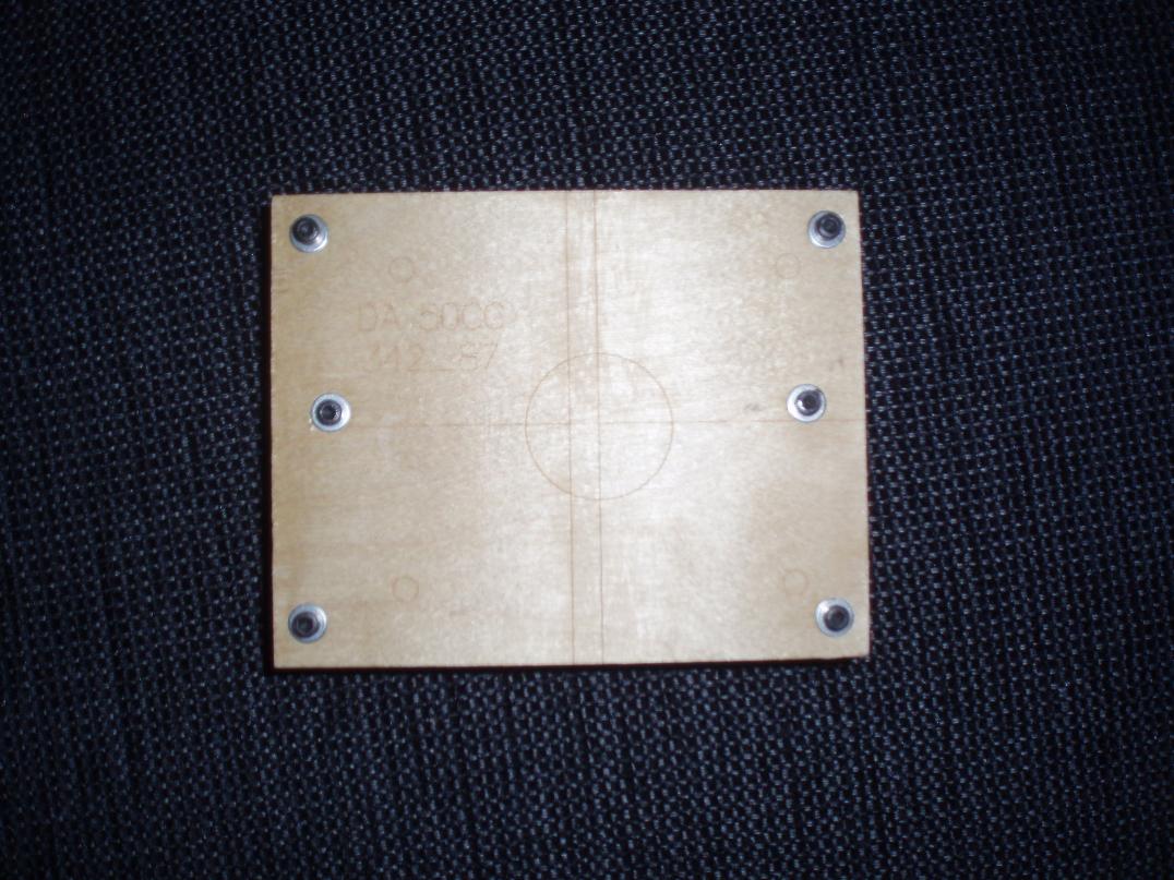

Ja nu har jag börjat fota lite delar till projektet.
