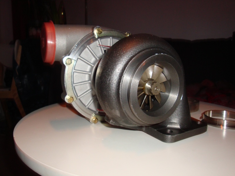

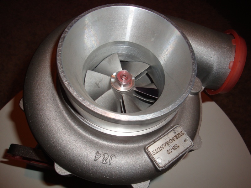

lite info om turbo:n
TB70 (T4)
Kompressor:
0,60 A/R
Inducer 70 mm
Exducer 92 mm
TRIM 57
Inlet 102 mm
360 lager
Turbin (avgashus):
0,68 A/R
T4 enkel (singel) fläns
Exducer (ut) 65 mm
Inducer 75 mm
Outlet 3" V-band
dumpen tial (kopia) 50mm
kör:v t4
